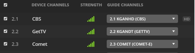

Is anyone else having trouble tuning in certain channels? My plex server isn’t able to tune CBS(which is channel two) My TVs hooked up to the same connection tune it in just fine. The settings also show that the signal is good.plexSignal

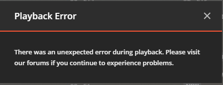

My tuner is a WinTV-HVR-22XX. I get the following error when trying to watch live TV.
