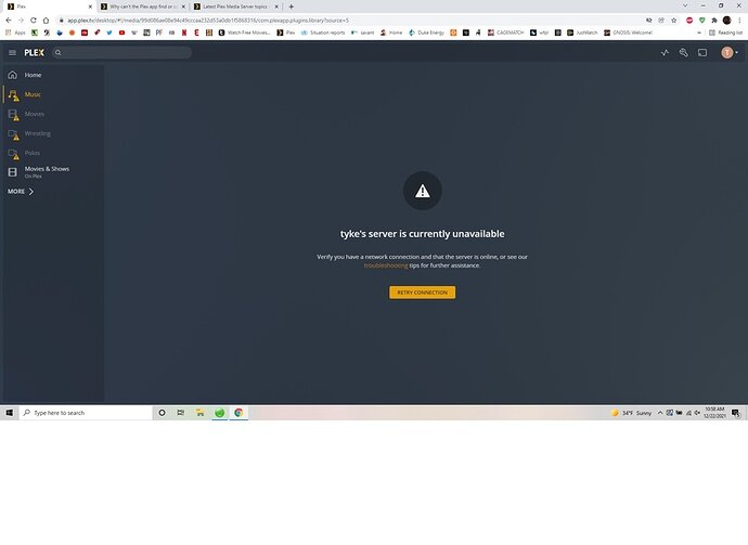

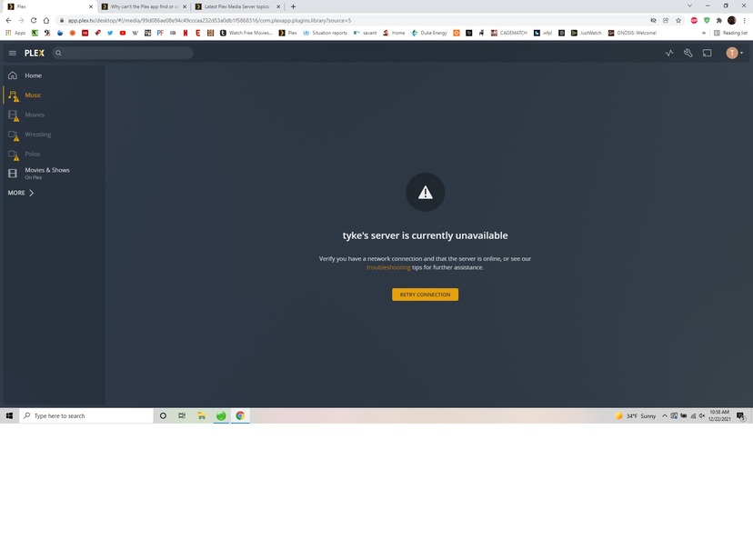

Suddenly my server is gone. Can’t connect to it at all. Server is my XHD, directly into my laptop. Latest version of Plex, updated just to be sure. Worked great yesterday. No changes to my computer. I have verified everything that I can from the troubleshooting. It just won’t connect. I’ve rebooted my modem/router and restarted my laptop as well. It’s just like it’s gone. I do NOT want to make a new server because I will lose my playlists, collections, updated tags, etc. What is the remedy?

Can you still access your server through the bundled version of Plex Web (e.g. http://127.0.0.1:32400/wb if you’re on the same machine; http://[PMS IP address]:32400/web otherwise)?
Did you perhaps recently change your account’s password and check the option to sign-out all devices?
hmmm…I did change my password and I think I did check sign-out. But I also signed back in using my updated password
THIS WORKED!!!
I accessed my server through plex web and was able to reclaim it!!! Thank you so so so so much!!!
Signing in the web app does not sign-in your server. That’s why you had to reclaim it (which requires a local connection).
