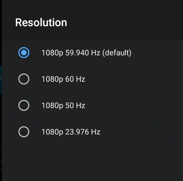

This is what my Nvidia Shield 2017 offers for display,
ok so it knows your TV doesn’t support 4K or HDR/DV,
