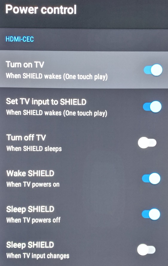

My setup: Shield → Denon AVR → LG B7 OLED
CEC settings on Shield:

If I turn off the Denon while playing a movie, Plex pops back to the pre-play screen.
The Denon is configured to pass through the last used HDMI input to the TV when turned off.
Here’s what happens:
  1. Play movie w/ Plex app
  2. Turn off Denon
  3. Audio & video stop for 2 - 3 seconds for Denon HDMI passthrough to kick in
  4. Plex app appears on-screen at movie pre-play screen, audio now via TV speakers.
