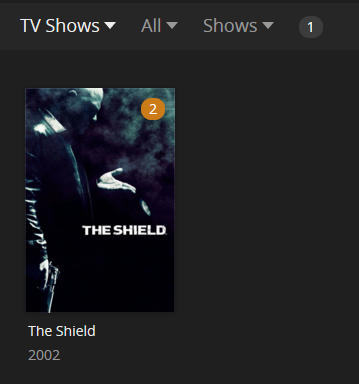

Pro gress :wink:
That’s enough for tonight!
Thanks guys!!
@CDLehner said:
Pro gress :wink:
All looking like it’s supposed to look. :slight_smile:
