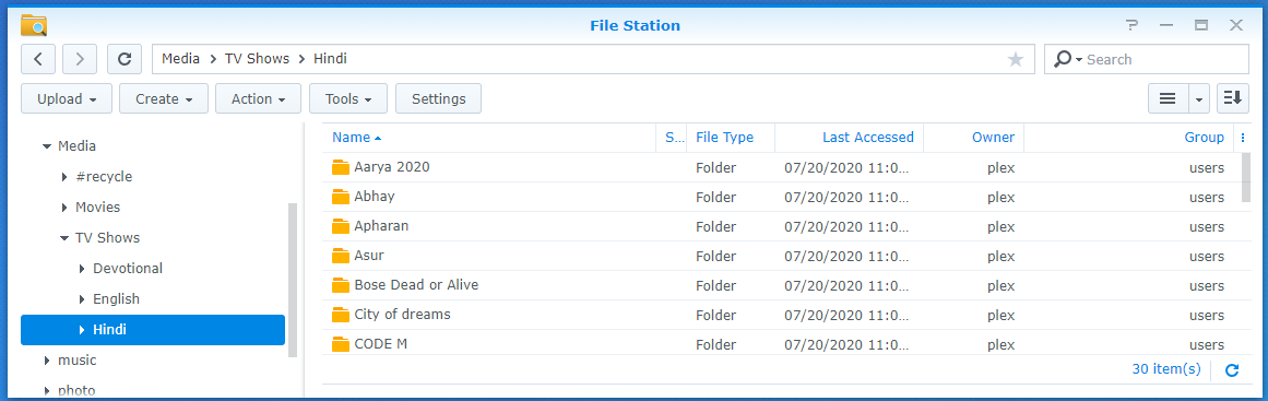

here is a screenshot from my Synology folder:
Plex very much depends on the folder structures to meet certain criteria.
In this setup, you’ll need to make sure the Plex library is looking at the Hindi folder – not the Series folder.
Edit: And super important… do not store your media in the Plex share. That’s for Plex’ internal data only!!

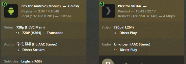

Do we know the differences between these 2 videos being played now? both by remote users?
one says Direct Play vs Transcode?

Transcoding can have a number of reasons…
  • the client does not support a certain format
  • the user has set a video/playback quality in their client that’s below the original video quality
  • subtitles… (either because the client cannot deal with the format or because the client is configured to burn those subtitles into the video)
If transcoding gives your server some headaches… best talk to your users and ask them to go for direct playback whenever possible.

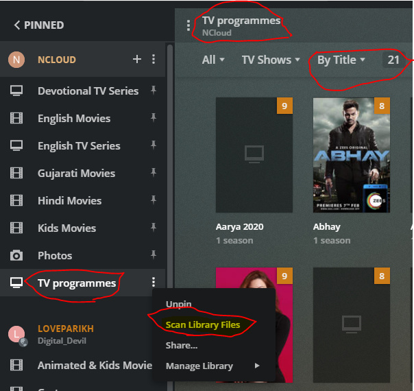

However, under Hindi (TV Shows) I have 30 series. However, when I see under PLEX, I only see 21. I noticed all recently updated / changed series are not updated…
I have done force update / sync my library but still end with the same results.
I have attached Plex Media Server log files as well. Let me know in case if you need further information here.
I appreciate your guidance to better understand if anything wrong I am still doing?

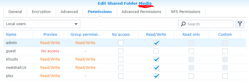

Check your file/folder permissions - confirmed, it has right access as per below:
On the Permission tab, highlight the Plex user and click on Edit/View and make sure the appropriate permissions are selected, then click on OK.
