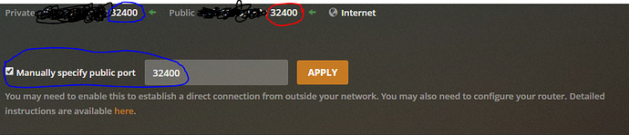

Settings>Remote Access
The one in the Red is the one you need to type in to canyouseeme. The Blue ones are important when we need to manually specify, which it’s looking more and more like we’re going to have to.
