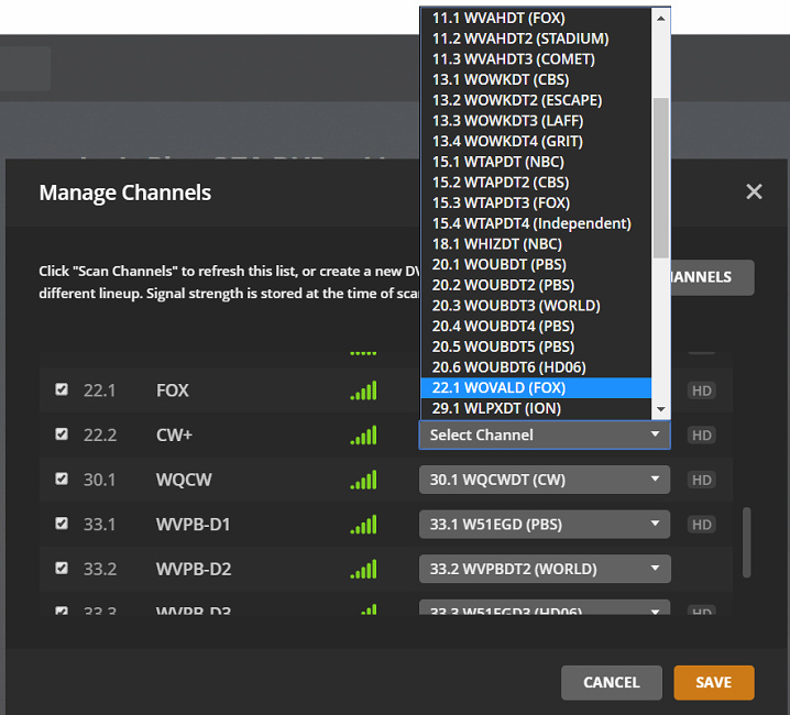

I’m having the exact same issue, also for 22.2 “CW+” in Parkersburg, WV. It seems that there is no way to select a CW+ station to assign to 22.2 since it’s not listed from WOVA-CW+ and there is no other CW+ station listed near our zip code.
Is there a way to manually edit a database table or XML file to assign another CW+ station manually to 22.2? Or, will there be a future update to allow a manual assignment? Thanks!
This is a work around that I found for 22.2 CW plus meta data. You can map the tuner as cable instead of antenna and use the CAS Cable guide. It has the guide data for the Parjersburg CW Plus channel. CAS has the most antenna channels in their line up to map to. However, if you do that there are other channels you will loose because they are not on CAS.

Thanks. I’ll give the CAS guide a try.
