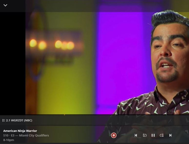

Here’s something even crazier, in the picture below I’ve clicked on channel 12.1, but it shows “2.1” (which is my proper NBC channel) As you can see it’s airing Masterchef which is what is currently on CHEX 12.1, not American Ninja like it says on the guide.
Also the NBC on 2.1 and the NBC it says is on 12.1 are different regions as the programming is slightly different, so I know it’s not just duplicating.

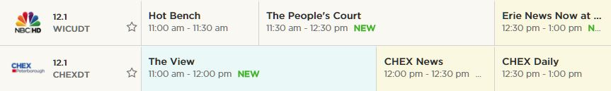

@jrbilodeau I’m on antenna and allowing Plex to gather the EPG data how it normally does. So when I’m matching up the channels, channel 12.1 matches up with the correct info (1st pic in the thread). When I go to the guide it doesn’t show the info for CHEX, it shows NBC (2nd pic in the thread). I’ve deleted the tuner, changed my postal code to another close by but no luck. I’ve troubleshooted the crap outta this on my end. Also I’ve done it with and without my VPN. no difference.

@DaveBinM Because @jrbilodeau told me to check out zap2xml after I put in the postal code I noticed the following. Which I’m assuming is the issue.
Yeah, that doesn’t look to be right. :face_with_raised_eyebrow:
