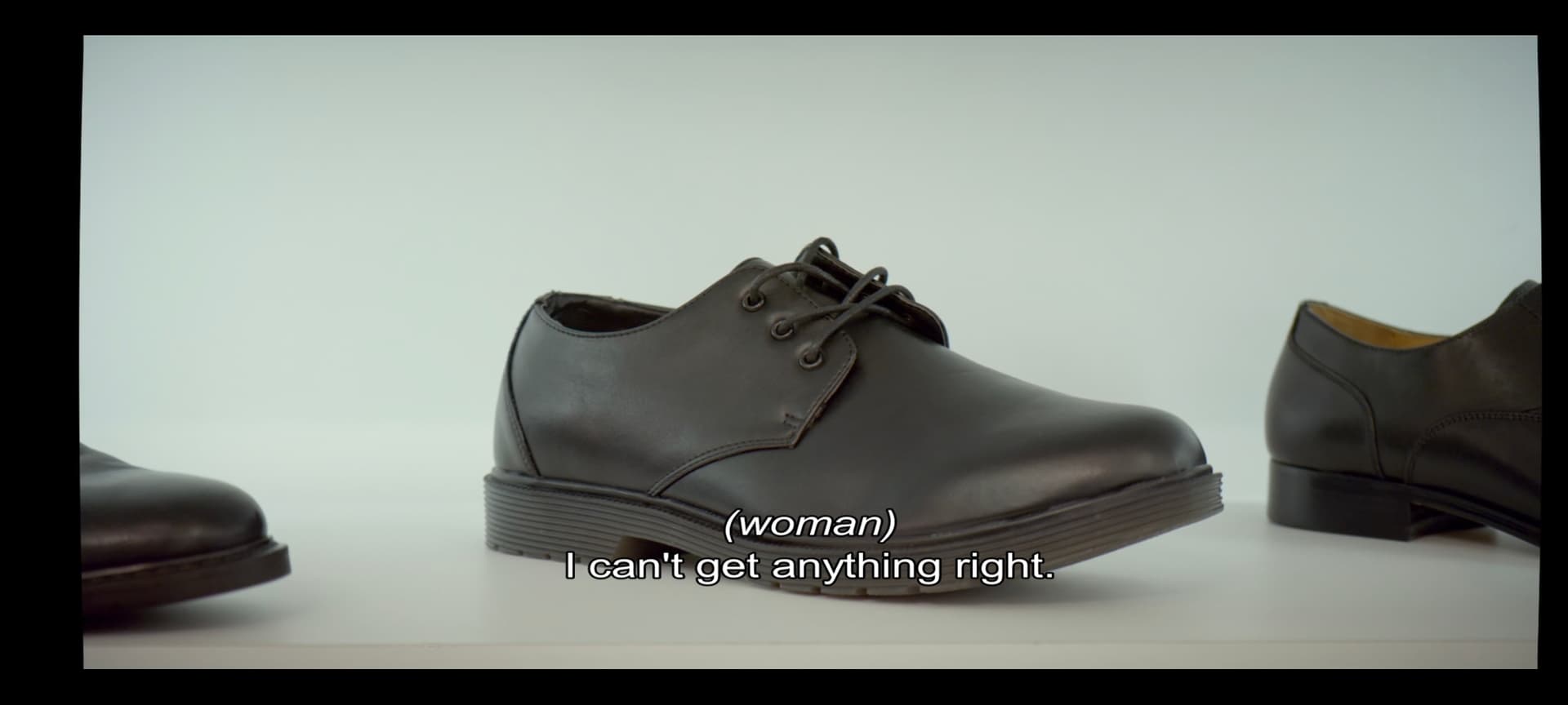

When I watch a movie with PGS subtitles on a device which supports PGS, the subtitles look the way they should. They seem to scale correctly despite the fact that the original video has been cropped to remove the black bars when transcoded in handbrake.

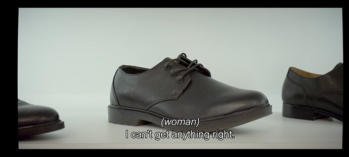

If however, Plex transcodes the same video to burn-in the subtitles, the subtitles get vertically squashed and appear to high up. I’m guessing the Plex transcoder is not taking into account the fact that the subtitles have a 1080x1920 canvas while the video has a 800x1920 resolution.
The same can be seen for 4:3 content where the black bars have been cropped out during encode. In that scenario, the subtitles get squashed horizontaly, but maintain the correct vertical position due to the height of the video still being 1080.

This is intended. That’s what happens when you have subtitles that are a different aspect ratio than the video (you really shouldn’t have them like this).
they seem to scale correctly
“seem” is the correct word. It only looks right in this case because it is just a single line of plain text. When being direct played, videos and images are scaled to fit the display. These are on different layers, there is no relationship between the 2. Each is just sized to fit the screen. If you had multi lines in the sub, they would extend beyond the bottom of the image. For plain text this may be fine, but if these were stylized and meant to line up with the video, that won’t work.
When we transcode, these 2 layers have to be combined. Since we don’t know how the video will be displayed, the only way to ensure both end up on screen is to scale them to the same size. Doing this also allows for stylized subtitles to line up with the video.
