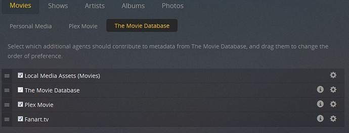

Go to Settings - Server - Agents - Shows - TheTVDB
In there, grab the line ā€˜Local Media Assets’ with your mouse and drag it downwards, so it ends up being at the bottom of the stack of active agents.
Repeat the same under
Settings - Server - Agents - Shows - TheMovieDatabase
Settings - Server - Agents - Movies - Plex Movie
Settings - Server - Agents - Movies - TheMovieDatabase

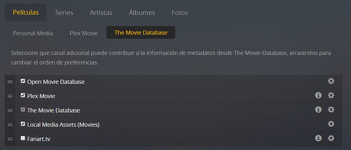

Hello everyone, someone who achieved the photos of the actors, since he installed the PMS a week ago, never appeared the photos of the actors. Please help to solve this problem.
  1. disable the OMDB agent
  2. Move the line ā€˜Local Media Assets’ downwards, below of the line ā€˜Plex Movie’
  3. have you set the ā€˜Cast List Source’ to ā€˜TheMovieDatabase’ as shown above?
thanks OttoKerner, it worked

  1. OMDB is 3rd-party, and unsupported. I have read quite a few reports that it doesn’t work properly anymore.
  2. mp4 files can have an embedded list of actors - but without links to pictures. So if ā€˜Local Media Assets’ is at the top, it will override the list of actors with pictures coming from the Plex Movie agent.
  3. was always necessary, since only TMDB will deliver a link to a photo
