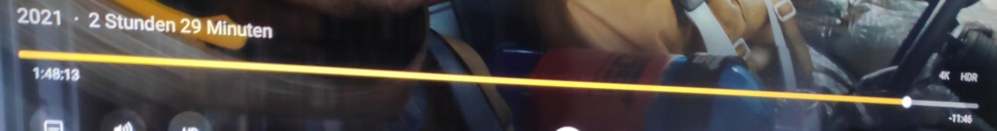

Lots of time I did experience the following: Playback of MKV content ends after 120min exactly - even with content that is much longer. This time I had a chance to get some details. Sorry for the blurred camera images, but I had to take them in a hurry.
Can please somebody explain the following:
I start a movie that has a length of 2:29 hours. Plex shows this correct length, but the slider shows 1:48:13 hours done and 11:46 min to go - giving 1:59:59 hours exactly (first picture). As you can see, the playback rest is wrong and ends at 1:59:59 exactly.

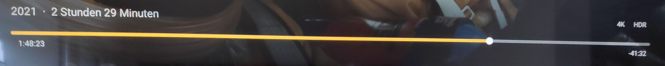

I stop the movie immediately. Plex thinks that I never played that movie and offers restart from the beginning only. So I start the movie from the beginning and fast forward to the last position. This time Plex shows 2:29 hours total, 1:48:23 hours done and the correct rest of 41:32 min.
