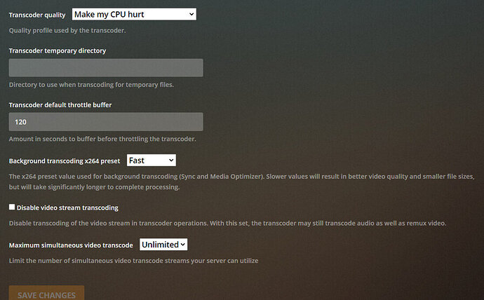

Not sure what I’m doin wrong. Verbose logging is turned off here… which is the only place I know about… any idea why its still showing up?
Either way, the video file provided did not produce the issue. I’ve had it happen on 3 of my own media files, all mkv format, all play fine outside of Plex.
Setttings - Server - General - SHOW ADVNCED (just as you are)
Uncheck DEBUG. SAVE
Now Check it and SAVE again.
Something goofy going on there indeed.
Rebooted server, came up as verbose still checked. Unchecked, checked debug, saved.
Rebooted again to verify changes took.

Where is your transcoder temp directory (or /var/lib/plexmediaserver/Library) located?
Is it on a network mount / share?
Your logs indicate it went to grab the file before it was there and got “Not Found”
Mar 02, 2021 21:46:06.897 [0x7fded77fe700] ERROR - Couldn’t find the file to stream: /var/lib/plexmediaserver/Library/Application Support/Plex Media Server/Cache/Transcode/Sessions/plex-transcode-dx467awixiayxnxwu5olgi22-2891d913-dad6-494b-a3c7-c1c2b2956d47/init-stream0.m4s,/var/lib/plexmediaserver/Library/Application Support/Plex Media Server/Cache/Transcode/Sessions/plex-transcode-dx467awixiayxnxwu5olgi22-2891d913-dad6-494b-a3c7-c1c2b2956d47/chunk-stream0-00430.m4s
This 404 (not found) usually occurs when the transcoder temporary directory is on a non-host-local file system.
I do not have one set up.
I assume there’s a default directory hidden somewhere… but this box is blank, and I don’t remember setting one.
