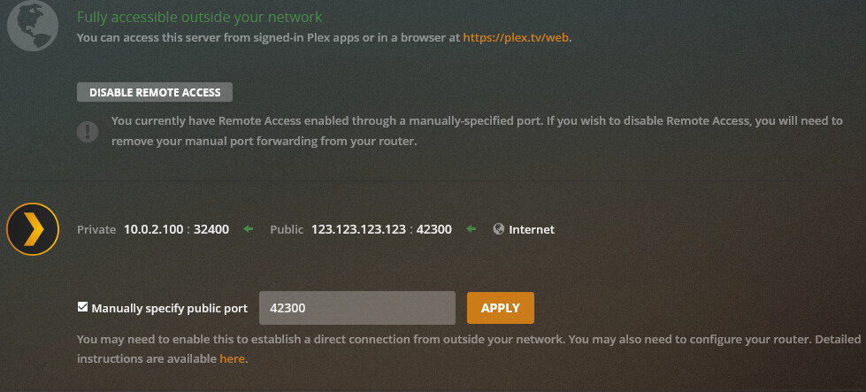

But the problem is that whenever I start a playback from anywhere, it shows up as a local one:
playback
The 10.0.2.100 is seemingly the container IP.

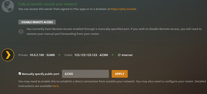

The remote access tab looks like this (except the 123.123.123.123 shows up as my actual public IP from hetzner):

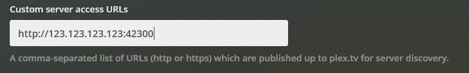

Upon reading further regarding the issue I came accross this setting as a potential way to solve my issue:
customurl
But even after defining this, the connections are still showing up as local ones.
