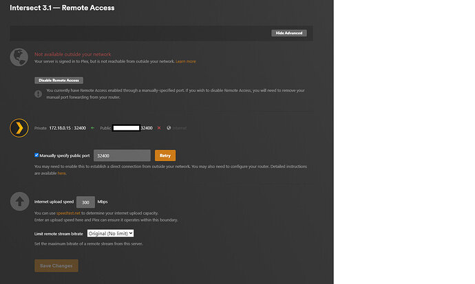

A few days ago, users began to send me complaints of poor video quality. I checked the dashboard while they were streaming and it said something about Indirect Playback. In addition, I can no longer get a stable Remote Connection on the Public Side under Settings → Remote Access for my server. It was working flawlessly until only a few days ago. The VM that is running the Server runs Ubuntu and has a static IP assigned in my router, along with port 32400 being opened. What can I do?

Disabled it and tested again. Still closed. Also, the IP in my router is different than the one on the website I’m testing. The one on my router forward is a 192.168, whereas the one on the website is a 50.93 address.
The port forwarding in your router should show the internal IP address of the machine you’re running the server on. (192.168.whatever), but I see in your Plex screen shot the private IP is 172.18.0.15
The internal and external port forwarding should be 32400. That routes your traffic to the external IP address which you won’t see in that part of the router settings.
this is because his server is a docker container. the 172 is the local docker network address however his local net is 192.
I see. I suspect then if you, manually input 172.18.0.15 into the port checking tool you’ll see that 324000 is open?
Nope, if I manually enter that into the port checker tool, it’s also closed.
