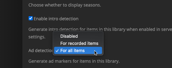

My Plex DVR settings are configured to detect commercials and mark for skip; the library above’s “Ad detection” setting is configured to “For all items.” My main library settings for the server are configured such that no automatic scanning is performed.

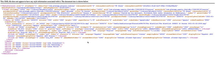

Hey thanks for the response, I just did a debug here is the results. I dont event see anything in the logs just detecting intros.

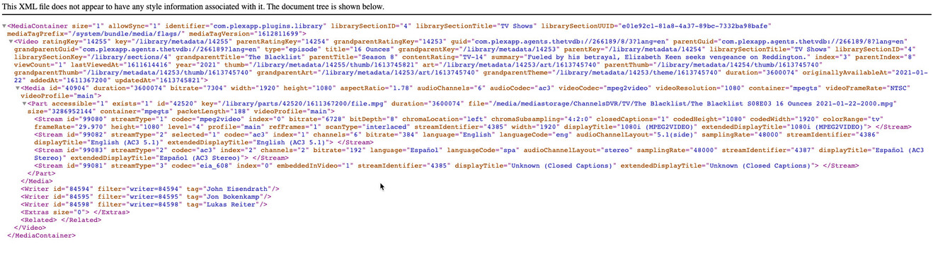

So tried again to run analyze I got some logs that say it is running now. However it still doesnt show / give the option to skip. Also in the XML information for the show it doesnt appear either.
