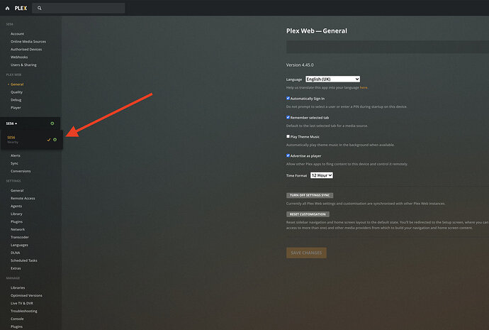

It sounds like your not local/Nearby.
But check the Quality setting in Roku settings is set to Original
It says Nearby on my server. On the Roku in the plex app it said 12 Mbps 4k for quality. I set it to Original and tried again but it is still all pixelated.
