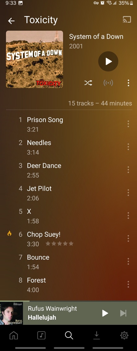

Same issue:
Server Version#: Version 1.40.1.8227 (Using Docker on Ubuntu)
Android Player Version#: 4.10.1
You can see from the screenshots that the name matches exactly even with casing with the name in my Library yet the matching with the app is failing.
Please find attached the screenshots and the logs

Ok, I think I figured this out.
So the only two songs that did not match happen to have an album with the exact name as the song.
System of a Down - Toxicity
System of a Down - Hypnotize
Toxicity and Hypnotize are both album names AND song names.
Looking at the API results, when it matches an album it is only returning the album match and not the song(track) match as well, which is failing Plexamp to match it.
In case there is no conflict and the song name is unique, the API results clearly show the track in the response.
Check the attached logs please to see the difference, one returns a , the other just returns a .
Hope this helps!

Thanks for the extra details, super helpful!
I’ve taken a look, and it appears to be a bug in Plex Media Server. I’ll keep investigating, and raise it with the right people.
