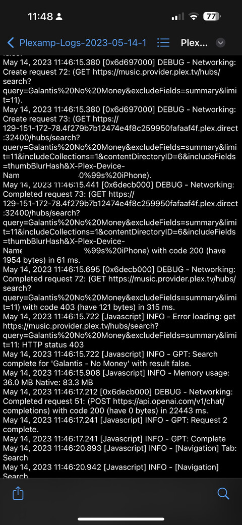

The Plexamp logs will show exactly what its search for and what it found and how it scored the matches.
Here’s a copy of a section of the logs when I searched “Discover new upbeat pop songs with electronic production similar to Sigala’s sound.” - one of the results was a “Galantis - No Money” which said not found but is in my library.
Do you see anything in it which points to the problem?

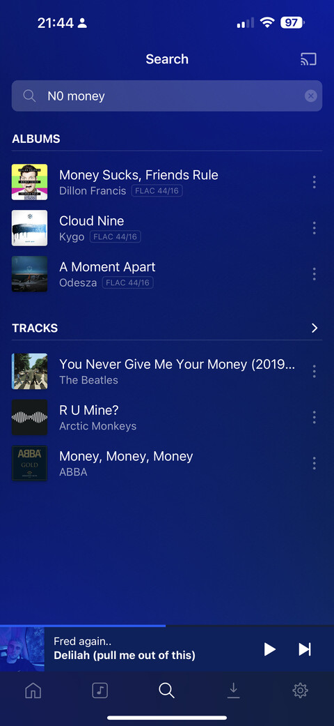

i meant search for it with regular plexamp search. The AI is using n0 money” with a zero, while yours probably doesn’t have the zero.
Using the regular search, nothing comes up:
And that is why Sonic Sage matching can’t find it either.

Here’s from my logs:
May 16, 2023 19:48:53.996 [Javascript] INFO - GPT: Search complete for ‘Wham! - Careless Whisper’ with result false.
May 16, 2023 19:49:00.858 [Javascript] INFO - GPT: Search complete for ‘George Michael - Father Figure’ with result false.
May 16, 2023 19:49:06.106 [Javascript] INFO - GPT: Search complete for ‘The Police - Every Breath You Take’ with result false.
May 16, 2023 19:49:11.493 [Javascript] INFO - GPT: Search complete for ‘Whitesnake - Is This Love’ with result false.
May 16, 2023 19:49:11.590 [Javascript] INFO - GPT: Search complete for ‘Bon Jovi - Livin’ on a Prayer’ with result true.
May 16, 2023 19:49:17.594 [Javascript] INFO - GPT: Search complete for ‘Foreigner - I Want to Know What Love Is’ with result false.
May 16, 2023 19:49:19.806 [Javascript] INFO - GPT: Search complete for ‘Journey - Don’t Stop Believin’’ with result false.
May 16, 2023 19:49:24.974 [Javascript] INFO - GPT: Search complete for ‘The Cure - Just Like Heaven’ with result false.
May 16, 2023 19:49:28.130 [Javascript] INFO - GPT: Search complete for ‘Bruce Springsteen - Dancing in the Dark’ with result true.
May 16, 2023 19:49:31.194 [Javascript] INFO - GPT: Search complete for ‘Cyndi Lauper - Time After Time’ with result false.
May 16, 2023 19:49:36.816 [Javascript] INFO - GPT: Search complete for ‘The Human League - Don’t You Want Me’ with result false.
