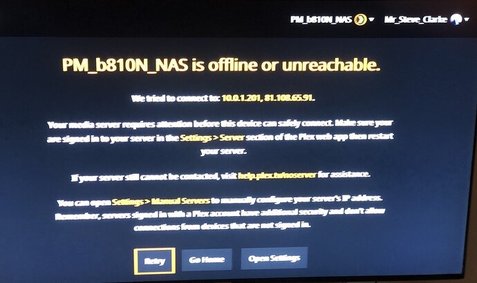

I seem to be getting a repeated error on Plex crashing on my Drobo B810n. When I start the app and start watching content, the content stops playing not far into the content (regardless of the content) and displays a connection error. When attempting to reconnect it fails.
Have ruled out a network issue as the cause as I also cannot connect to the plex media server on the drobo even from the browser or any other device. Only a restart of the plex media server app on the drobo resolves the issue. Sometimes this resolution fixes the issue for several hours and sometimes it only works for several minutes before another restart is required.
