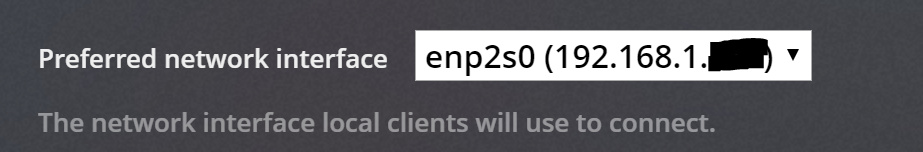

Plex keeps binding to this local 172 address:
But I want it to bind to a 192 address as shown below.
Remote access is not working as it is binding to the wrong address.
I can’t for the life of me figure out why it’s forcing the 172 address. HELP!

You will need to manually port forward (you seem like you have the know how) That preferred network interface is only for local clients to connect, it does not tell the router which IP to use for UPnP
@damtor @BigWheel Thanks for the replies! I have fixed the issue and want to share. It’s obscure.
So I am running Ubuntu 19.04 and have one interface going to one network 192. And another going to the 172 network.
The 2nd adapter I configured manually under /etc/network/interfaces
I had one configured automagically by Ubuntu through NetworkManager and since I did the 2nd one manually through /etc/network/interfaces it screwed things up in Plex.
Once I had them all configured through Network Manager Plex had no problems binding to the correct address.
All is good now.
