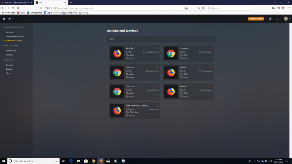

Late last night my Plex went offline and couldn’t find out why until I got home from work. When I got home I found that my Plex server was still running but could not be seen on any device including host computer on any address. I’ve gone through a few different support pages and have not been able to solve my problem. The only thing I can think of is that my devices are all unauthorized for some reason and I can’t find out how to fix it.
The server on your account got removed about 23 hours ago.
