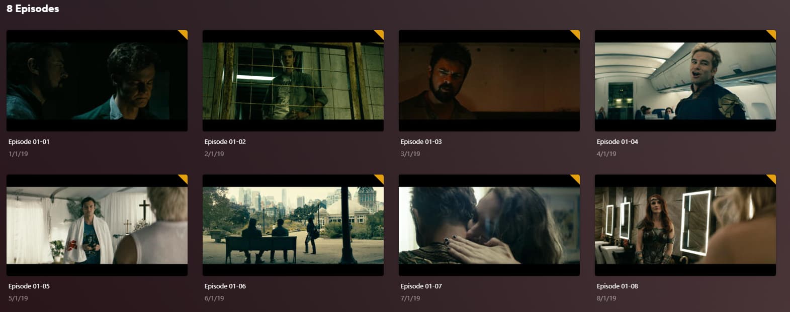

A lot of my tv-shows have either disapperad or are missing huge amounts of episodes or are in the Plex server incorrectly.
As this season for example:
This is how the episodes are shown in the actual folder (That I havent changed for years)
And this is Season 2 that doesnt show in Plex at all. The episode on top I tried to rename to see if that was the issue, but it still doesn’t show up.
