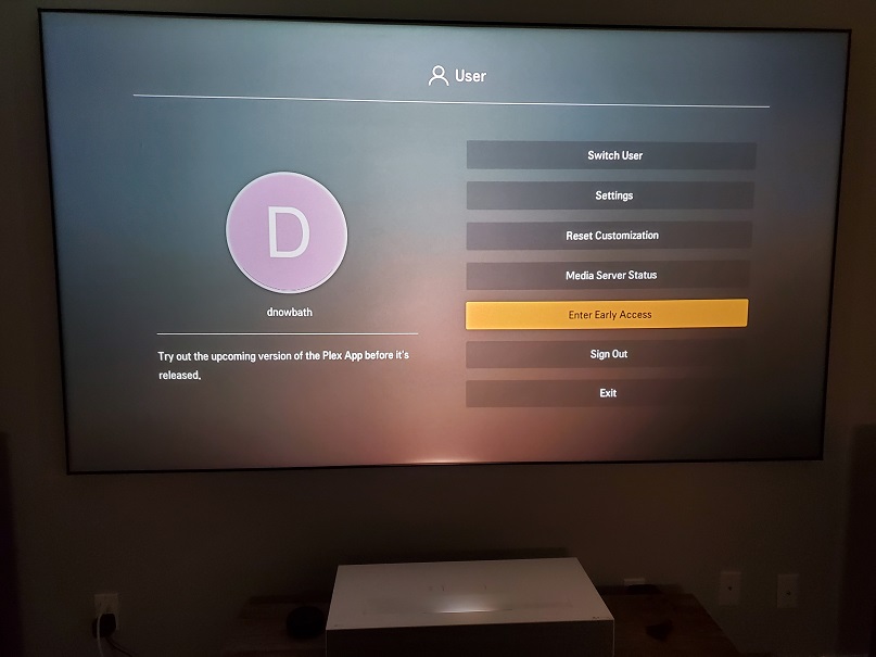

Edit: Was able to select leave early access and revert back to the 2.2.0 client.

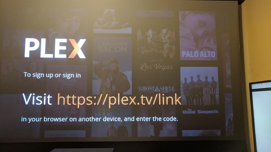

I reinitialized to factory defaults and reloaded Plex. I can’t link Plex now because the Code is below the bottom of the screen.

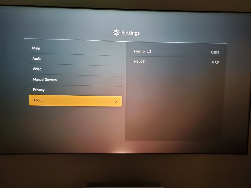

WebOS version 04.00.06, no updates available.
LG Projector HU85LA

Image of code screen. I can’t link my device because I can’t see or get to where the code would be below the bottom edge of the screen.
New early access client looks good! No scaling issues
