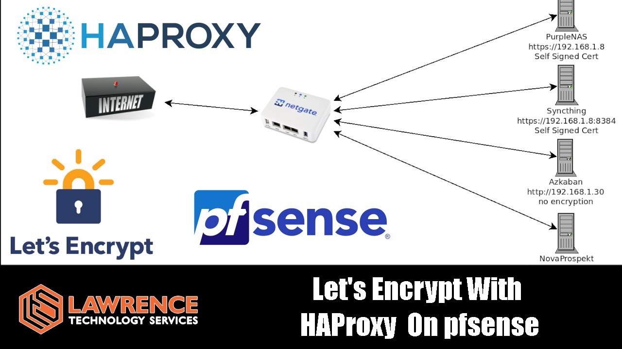

I run my PMS out of a docker on unraid. I have a typical pfsense / haproxy / letsencrypt / cloudfare setup as described here:

@OttoKerner One thing that came to mind. In the instructional video linked above. The frontEnd “Listen Address” is set to WAN only. perhaps this is supposed to be set to WAN+LAN instead to enable the rebinding?
