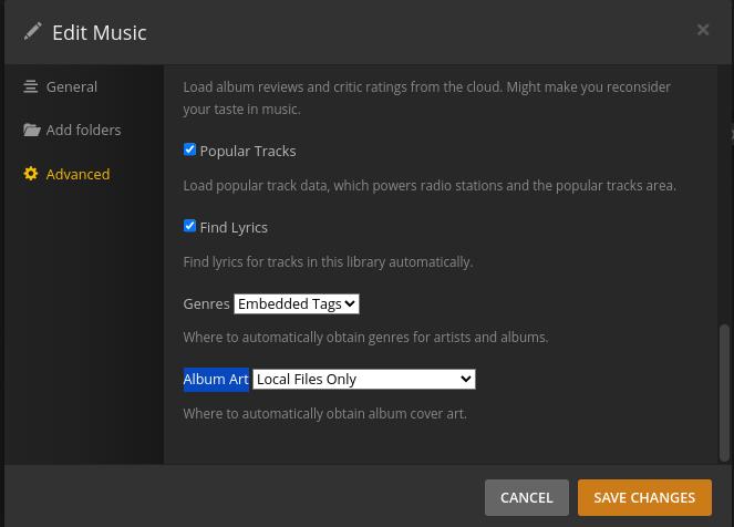

If indeed your album artwork is embedded in your files ensure within the advanced settings of your music library that album art is set to local files only. That way plex will ignore all its own stuff from their cloud and only use your local files.
Screenshot from 2022-09-21 11-13-15
I’ve done this and it works perfectly within my music library.

Then, within the music library advanced settings I have Album Art set to Local Files only.
Screenshot from 2022-09-23 17-23-38
I then have clean artwork within my media and nothing from the plex cloud.

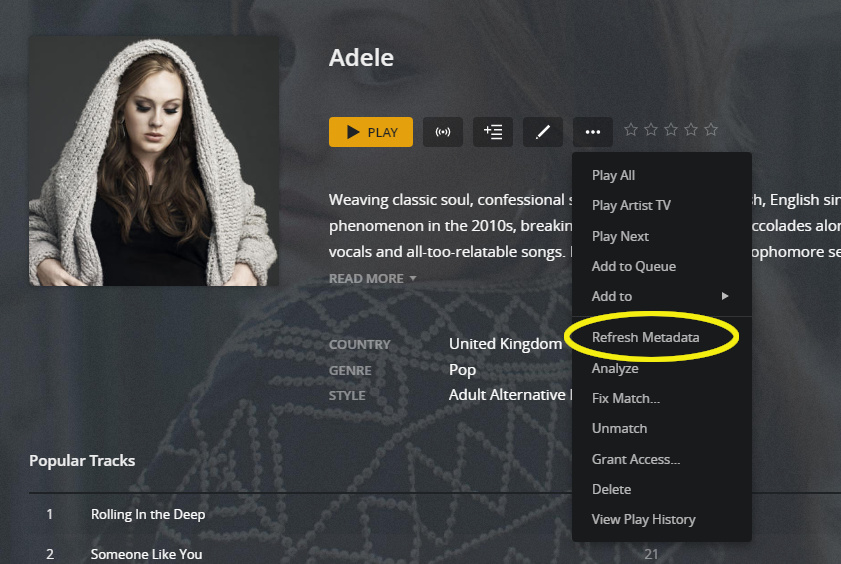

I would try “Refresh Metadata” at the artist level. Plex likes to hold onto old metadata. Refreshing the metadata at an album level never works for me, but at the artist level it does.
