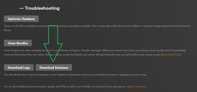

This will save a zipped database to your browser’s default download folder.
Not sure how I can do that since the server crashes immediately, within seconds. Is there another way to get that?
https://support.plex.tv/articles/202915258-where-is-the-plex-media-server-data-directory-located/
