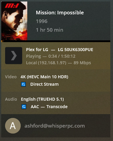

When playing Mission Impossible the video is transcoding. This can cause stuttering/buffering.
It looks like PGS subtitles are enabled and TrueHD audio is selected.
Keep in mind the limitations of the Plex SmartTV client:
  1. Enabling image based subtitles, PGS / VOBSUB, forces a video transcode.
  2. If the audio is transcoding, enabling text based subtitles, SRT, forces a video transcode.
When using the Plex LG client, you should avoid TrueHD audio, as it is not supported by the TV. TrueHD audio will be transcoded by the Plex server, and this will force a video transcode if subtitles are enabled. When possible, choose Dolby Digital or dts audio.
Try playing Mission Impossible with subtitles turned off and, if available, with a Dolby Digital or dts audio stream.
When playing Mission Impossible the Video is transcoding.
The server says it’s “Direct Stream”. That shouldn’t be transcoding.

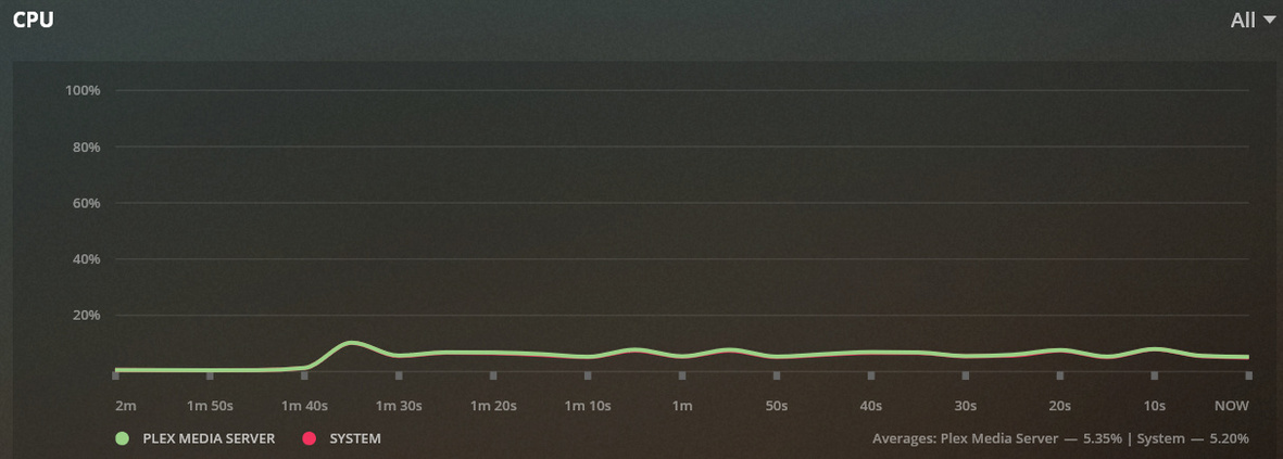

The subtitles are turned off (not being displayed). If the video were transcoding, the server CPU would be pegged (my understanding is that the transcoding is done in the Plex server). It’s not.
The small bump is the initial buffering.

I’ve a B7 OLED with Plex app v4.27.1. Mission Impossible buffers, but does not crash the app or reboot the TV. The buffering is due to the high video bitrate and using the 100 Mbps Ethernet port on the TV. It buffers whether I choose the TrueHD or AC3 audio tracks.
Hopefully one of the Ninjas/employees/developers will pick up on this thread.
I have no problem with the buffering. In fact, I expect it. The app should always try to stay ahead by a bit, as there can be quite a bit of latency getting the next chunk of the movie, and the app doesn’t know ahead of time exactly what the bit-rate is for a given segment (I believe the 89 in the image is the average bit-rate).
