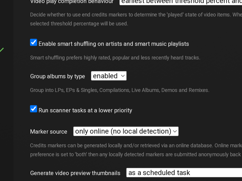

Your credit markers are from what source? Local detection usually fails on Nvidia Shield.
System isn’t powerful enough to do a good job, I usually just depend on the the cloud setting as below
Marker source.
I tried every options multiple times.
Well, keep it on online and observe for a few maintenance cycles. Then check XML file information to see if any file information is updated with markers. If your collection is unique i.e. not typical viewing them maybe it can’t exactly be crowd sourced i.e. can’t be found on the cloud. If there is anything unique about the media files, then that could also be a factor since unique files won’t be able to be crowd sourced either. I have a few of those as myself and they can’t be marked via the cloud.
