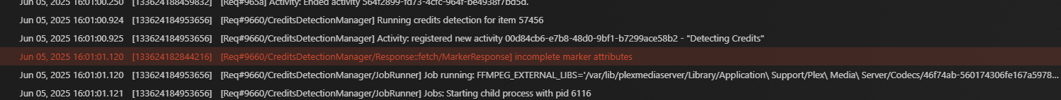

This is the first error that pops up after clicking analyze.
Then these two at the end of the log after it “finishes”
If posting the full logs will help let me know.

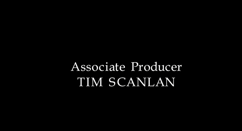

I uploaded a straight rip of a Smallville episode, and it still failed at detecting credits
This is what the credits look like

This is the full error that always happens.
[CreditsDetectionManager] Job failed: OpenCV(4.5.5-pre) /home/runner/_work/plex-conan/plex-conan/.conan/data/opencv/4.5.5-9699e2b-31/plex/main/build/66dee93a0b15e6bb4263d09f6ada705e436786ae/opencv/modules/dnn/src/tensorflow/tf_importer.cpp:2984: error: (-215:Assertion failed) netBinSize || netTxtSize in function ‘populateNet’
This is after disabling checking online for credit markers and only doing local scans.
