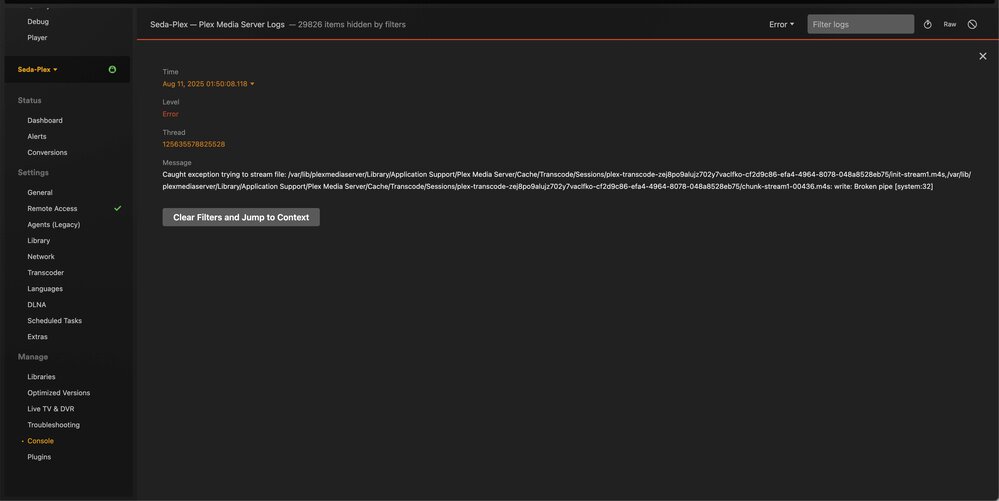

Plex Media Server.2.log - Snippet
Aug 07, 2025 19:32:08.432 [138932705999672] DEBUG - [Req#1a53d/Transcode/r0bv2f262pf6k3fozcufutvj/94d1b0b3-6f67-4f88-a3b3-2bef45281da5] Session r0bv2f262pf6k3fozcufutvj (4) is unthrottling
Aug 07, 2025 19:32:08.432 [138932642904888] DEBUG - [Req#1a543/Transcode/r0bv2f262pf6k3fozcufutvj/94d1b0b3-6f67-4f88-a3b3-2bef45281da5] Throttle - Getting back to work.
Aug 07, 2025 19:32:08.485 [138932646308664] DEBUG - [Req#1a537/Transcode/r0bv2f262pf6k3fozcufutvj/94d1b0b3-6f67-4f88-a3b3-2bef45281da5] Transcoder segment range: 4234 - 5445 (5445)
Aug 07, 2025 19:32:08.524 [138932625419064] DEBUG - [Req#1a545/Transcode/ipd4mj2qew5pu55d1bdj7tby/46a9a7d3-40ee-430c-80dd-5f7fb101c12b] Transcoder segment range: 4225 - 5498 (5498)
Aug 07, 2025 19:32:08.659 [138932639345464] DEBUG - Request: [76.86.109.179:55128 (WAN)] GET /video/:/transcode/universal/session/r0bv2f262pf6k3fozcufutvj/1/5204.m4s (32 live) #1a539 TLS GZIP Signed-in
Aug 07, 2025 19:32:08.660 [138932639345464] DEBUG - [Req#1a539/Transcode/r0bv2f262pf6k3fozcufutvj] Asked for segment 5204 from session.
Aug 07, 2025 19:32:08.660 [138932639345464] DEBUG - [Req#1a539/Transcode/r0bv2f262pf6k3fozcufutvj] Returning segment 5204 from session
Aug 07, 2025 19:32:08.660 [138932639345464] DEBUG - Content-Length of /config/Library/Application Support/Plex Media Server/Cache/Transcode/Sessions/plex-transcode-r0bv2f262pf6k3fozcufutvj-94d1b0b3-6f67-4f88-a3b3-2bef45281da5/init-stream1.m4s,/config/Library/Application Support/Plex Media Server/Cache/Transcode/Sessions/plex-transcode-r0bv2f262pf6k3fozcufutvj-94d1b0b3-6f67-4f88-a3b3-2bef45281da5/chunk-stream1-05205.m4s is 19511 (of total: 19511).
Aug 07, 2025 19:33:48.091 [138932739910456] DEBUG - [ViewStateSync] Starting

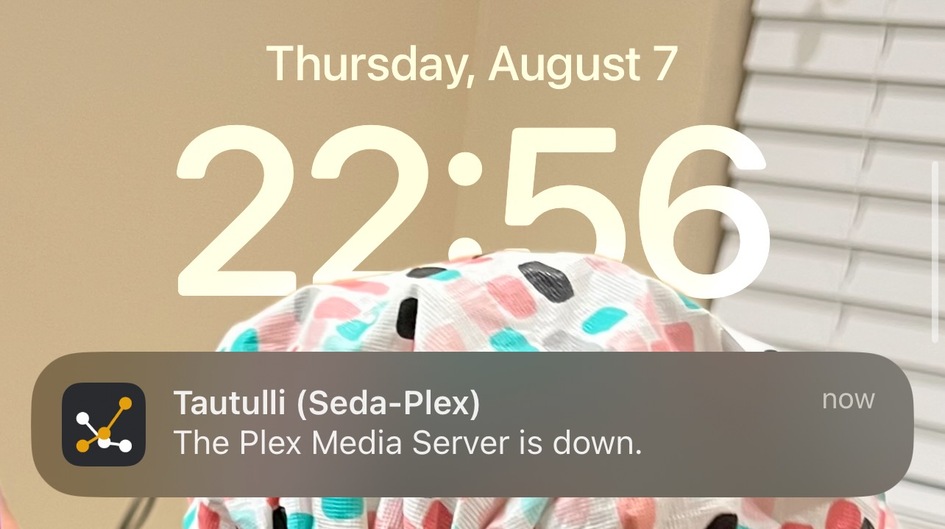

I am going through the logs from when PMS went offline late last night (Aug. 7, 2025 around 22:53). Here is what I see after reviewing the Plex Media Server.1.log and the tautulli.log:
  • Prior to 22:53, there are two playback sessions taking place
    • Last activity for user ‘n***7’ was 22:53:10
    • Last activity for user ‘d***35’ was 22:53:14
  • 22:53:29 - Tautulli is reporting a connect timeout and marks Plex down 3 seconds later
  • 22:55:48 - Tautulli sends notification to phone
  • 22:56:36 - PMS begins to terminate timed out sessions
  • 22:56:52 - PMS host has docker.service restarted by user
For what it is worth, during this time that Plex is down I cannot access the web UI via the local IP address (10.1.2.30). I have a health check in the Docker run config ( --health-cmd=“curl -f http://localhost:32400/web || exit 1”) and during this time Docker shows the container as “unhealthy”.

  • 22:47 - (22:48:59) ------ WAN IP ----- ???
  • 22:52 - Library update begins
  • 22:52 - Update movies
  • 22:52 - Update tv
  • 22:53:42 - Updating IP / Reachability
  • 22:53:42 - State set to unknown
  • 22:53:42 - Update IP / Reachability complete
  • 22:53:43 - Preferred interface preference IGNORED (no valid IP address)
  • 22:53:43 - Mapped
  • 22:56:36 - Resetting Android streaming session
  • 22:56:52 - Server shutdown ordered.

@ChuckPa QUICK UPDATE:
I completely rebuilt my Plex server–reloaded the OS, installed a fresh copy of Plex in Docker, and allowed Plex to rebuild all metadata (with one exception: I copied the watch state from previous Plex database). Without failure, I can easily get Plex into this unresponsive state just by starting two 4K transcodes. I figured, “maybe something is wrong with Plex” and therefore installed Plex natively into the OS. Started two transcodes and voila, Plex went down again! Here’s a screenshot of the last error I saw in the console before things went dark.
I’ll attach the logs from when this occurred. In my opinion, this is pointing to an issue with Plex and not the server, which has handled 6 concurrent transcodes in the past without any issues (per Tautulli).
Please let me know what additional details or tests I can run to help identify root cause. I can even grant remote access, if you wish.
