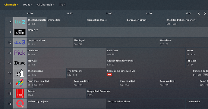

I’ve seen many posts about this issue but it still hasn’t been fixed. My timedatectl is correctly set to Europe/London, I’ve tried adding the TZ env variable set to Europe/London, but the TV Guide is still 1 hour behind, seemingly ignoring daylight savings. Please either fix, or provide the option to override the OS timezone in PMS itself.

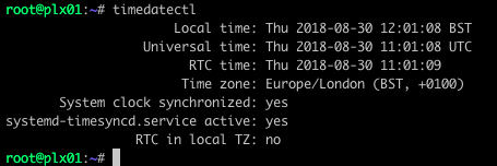

The log is attached, interestingly, the filename shows the correct time, so I’ve attached a screenshot of the TV guide, which is an hour behind. I’ve also included the output of timedatectl. Distro is Ubuntu, 18.04.1, Kernel: Linux plx01.xxx.xxx.xxx 4.15.0-33-generic #36-Ubuntu SMP Wed Aug 15 16:00:05 UTC 2018 x86_64 x86_64 x86_64 GNU/Linux.

Interestingly, I have
[chuck@lizum ~.101]$ timedatectl status
                      Local time: Thu 2018-08-30 10:33:22 EDT
                  Universal time: Thu 2018-08-30 14:33:22 UTC
        RTC time: n/a
                       Time zone: America/New_York (EDT, -0400)
       System clock synchronized: yes
systemd-timesyncd.service active: yes
                 RTC in local TZ: yes
Warning: The system is configured to read the RTC time in the local time zone.
         This mode can not be fully supported. It will create various problems
         with time zone changes and daylight saving time adjustments. The RTC
         time is never updated, it relies on external facilities to maintain it.
         If at all possible, use RTC in UTC by calling
         'timedatectl set-local-rtc 0'.
[chuck@lizum ~.102]$
I am EST5EDT timezone (Eastern US) and EPG is correct. I therefore wonder if the EPG info is being provided in UTC or BST ?
Ok, so please don’t shoot me. I was doing some JS stuff and noticed by browser was returning the wrong time for date(). Turns out I’d turned on Firefox’s “privacy.resistFingerprinting”, which forces the JS timezone to UTC, hence why I was seeing the wrong stuff in the guide. So sorry for bothering you! Had no idea it had that effect! Thanks for the help!
