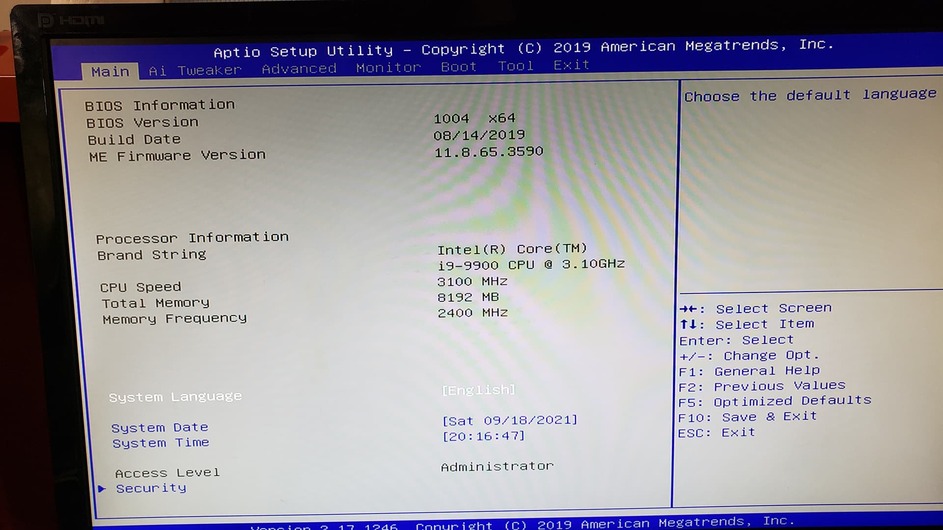

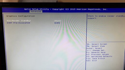

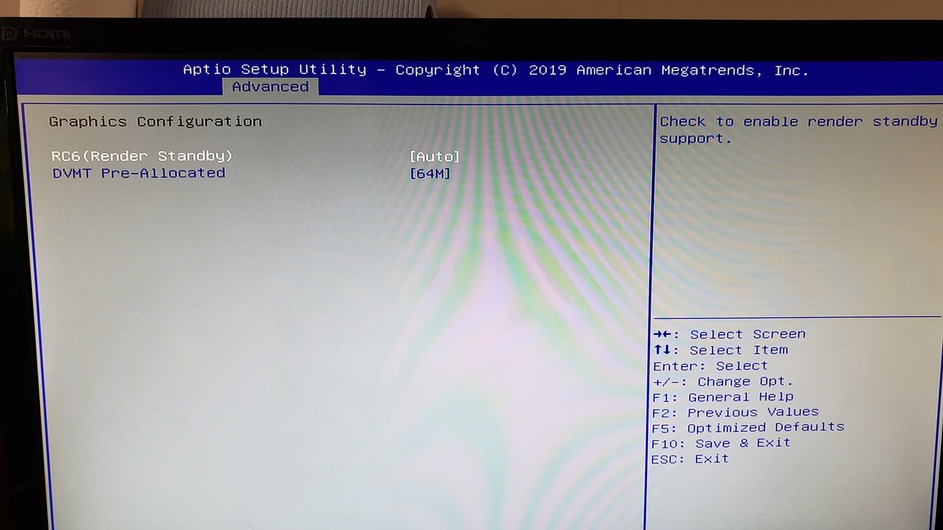

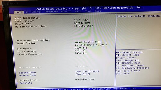

Can you determine from these BIOS screenshots whether QSV is enabled? I couldn’t find a reference to QSV under the Graphics Configuration Section (ADVANCED).
What’s under `Graphics Configuration’ ?
That looks like an important one :wink:
See photo 4 … “Graphics Configuration” at the top, below the “Advanced” tab.
Thanks. that just tells us you can change the status of the onboard VGA adapter.
It’s not showing the status of the QSV.
