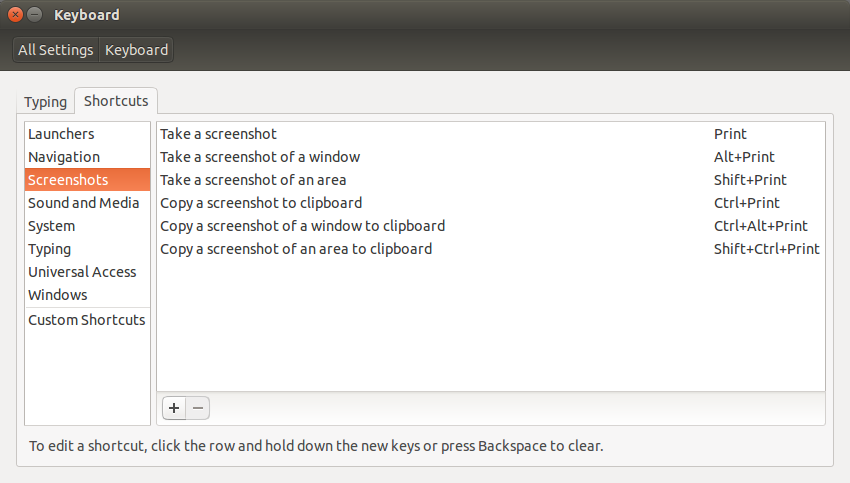

first things first…
here’s how to create screenshots from your Ubuntu system
