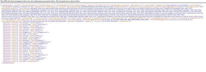

All I have is this
brave_SOCSELQvg6.png | XBackBone
Server is up and running… you’re just missing out some parts of the URL (or added some others).
To confirm it’s working you can even open the domain name listed in the XML file, append :32400/web and it’ll open Plex Web. Though… as the server isn’t claimed (see myPlexSigninState="none"), you’re still not able to do anything with it.
To finish the setup you need a local connection.
You can achieve that e.g. by using the SSH tunnel explained above.
