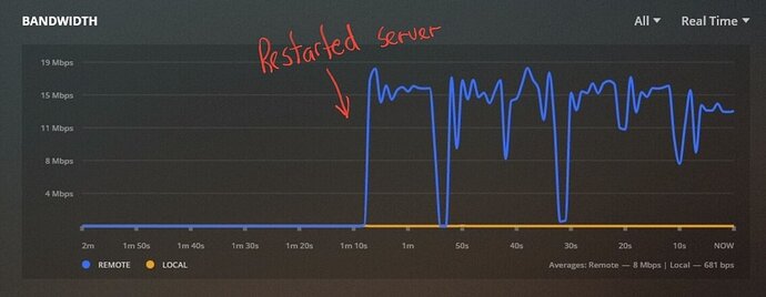

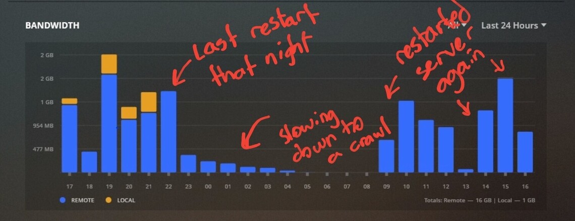

I attached some screenshots of the last 24 hours. As we can see, I restarted the server yesterday night until around 11PM. From there, we can see the download speed decreasing slowly until it’s almost nothing. Then I restarted the server in the morning, which restored the download speed.
Then during the day I had to restart a couple of times because the speed would degrade over time.
Yes, that first set of graphs is very much what I experienced. It was very fast at 50+ Mbps during the first day and then slowed down greatly to about 10 Mbps. Then more gradually about halving everyday or so.
