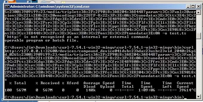

hmm, ok can you try curl http://127.0.0.1:32600/devices/compound_device041dvb%23bda%23usb%23vid_2040%26pid_0265%230013909199%23/media/triplet%3A%2F%2F9018%3A8204%3A8448?param=%3C%3Fxml%20version%3D%221%2E0%22%20encoding%3D%22UTF-8%22%3F%3E%0A%3Ctunedata%3E%3Ctt%3E4%3C%2Ftt%3E%3Cdq%3E0%3C%2Fdq%3E%3Cdr%2F%3E%3Cfr%3E489800%3C%2Ffr%3E%3Cmd%3E0%3C%2Fmd%3E%3Csr%3E0%3C%2Fsr%3E%3Cpl%3E0%3C%2Fpl%3E%3Clf%3E8%3C%2Flf%3E%3Cl1%3E0%3C%2Fl1%3E%3Cl2%3E0%3C%2Fl2%3E%3Cls%3E0%3C%2Fls%3E%3Cpp%3E0%3C%2Fpp%3E%3Chz%3E0%3C%2Fhz%3E%3Cin%3E0%3C%2Fin%3E%3Cfc%3E0%3C%2Ffc%3E%3Ct%3E8204%3C%2Ft%3E%3Cn%3E9018%3C%2Fn%3E%3Cs%3E8448%3C%2Fs%3E%3Cen%3E0%3C%2Fen%3E%3C%2Ftunedata%3E%0A -o test.ts leave it running for a while see if it stops. to manually stop press CTRL + C
I let it run for over an hour and the file played fine. Screenshot below, i dont believe its signal related. My youview (ran from same booster) always has 100% signal and never see issues on SD channels. On the odd ocasions (windy\rainy) the HD channels can be a little flakey but never bad enough to turn over.
