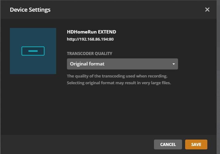

I have checked the signal quality of the OTA channels HDHomeRun Extend is receiving and all looks good (100% signal). I am suspicious the Plex DVR on the shield is not quite keeping up or failing somewhere during recording, however not quite sure how to debug. I have my HDHomeRun Extend Default Transcode Profile set to ā€˜none’. The Plex DVR Transcoder Quality settings is set to ā€˜Highest Quality’.

Edit - sorry, I was looking for the Transcoder quality, which isn’t there.
