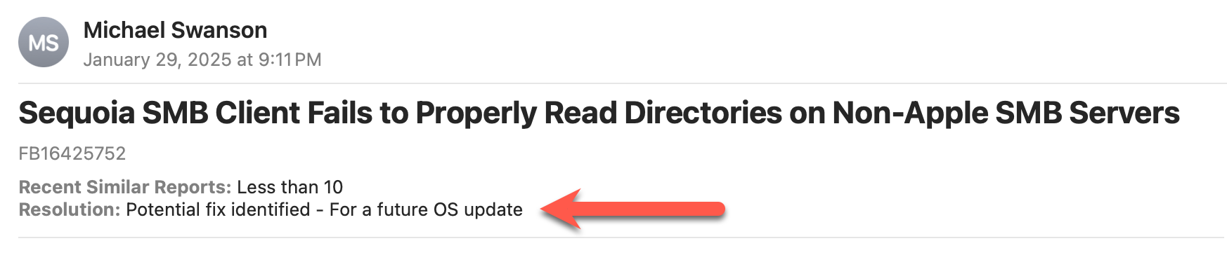

It’s still a bug that has been filed with Apple (so in that sense, it isn’t fixed). However, if you haven’t added the nsmb.conf file yet, that’s worth a try: Plex Files Unavailable but they’re not missing - #413 by Anyware
