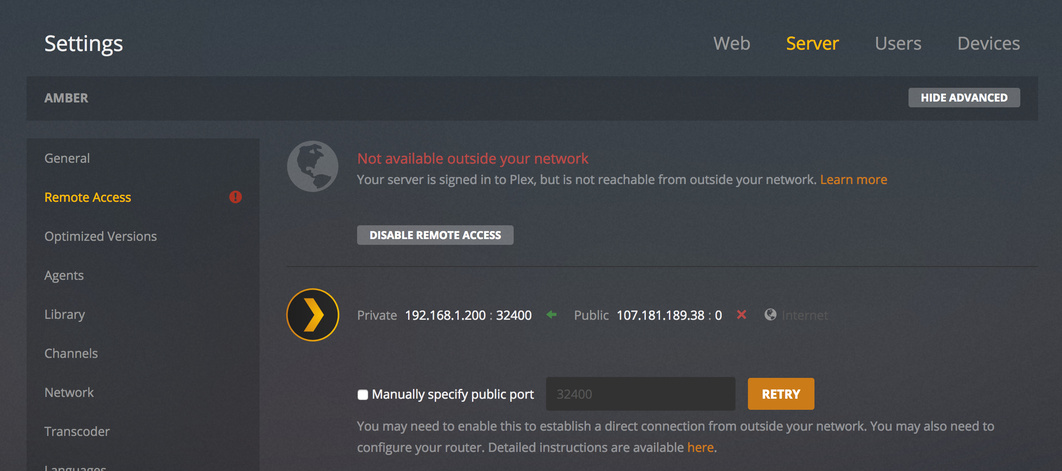

Plex finding wrong external IP address for remote access - help?
I’ve been having problems with remotely accessing Plex lately (after many months of it working well). Playback can be slow or disconnects. One possible reason I’ve found is that the external IP address Plex reports is incorrect - seems to be stuck on a VPN server address from the past. Whatever the case, it’s definitely not the public IP address that’s reported by whatismyip.com.
I’ve deleted all of my servers from Settings->Devices and logged back into the sole QNAP NAS server. I’ve also uninstalled and reinstalled it. Nothing seems to work - remote access always fails, even when logged in.
Can anyone suggest how to clear and reset the external IP address Plex uses?

When you do get a ‘wrong’ IP, is is a bad public IP or is it a LAN IP showing ?
The “wrong” IP (that Plex is finding) is 107.181.189.42; checking whatismyip.com gives me the correct, public (non LAN) IP: 97.113.xxx.xxx. Happy to share the full public IP privately if it helps, but suspect the issue is that Plex keeps attempting to connect via the (wrong) 107.181.189.42 IP.

UPDATE: just noticed that the wrong IP address Plex is finding has changed! The original “bad” one ended in .189.42 - the new one (as you can see in the screenshot link above) is .189.34! Significant?

Note that the new, “wrong” IP address is now a .38 - so it’s changed again. However, it’s still not the public IP of 97.113.29.XXX as reported by whatismyip.com. :frowning:

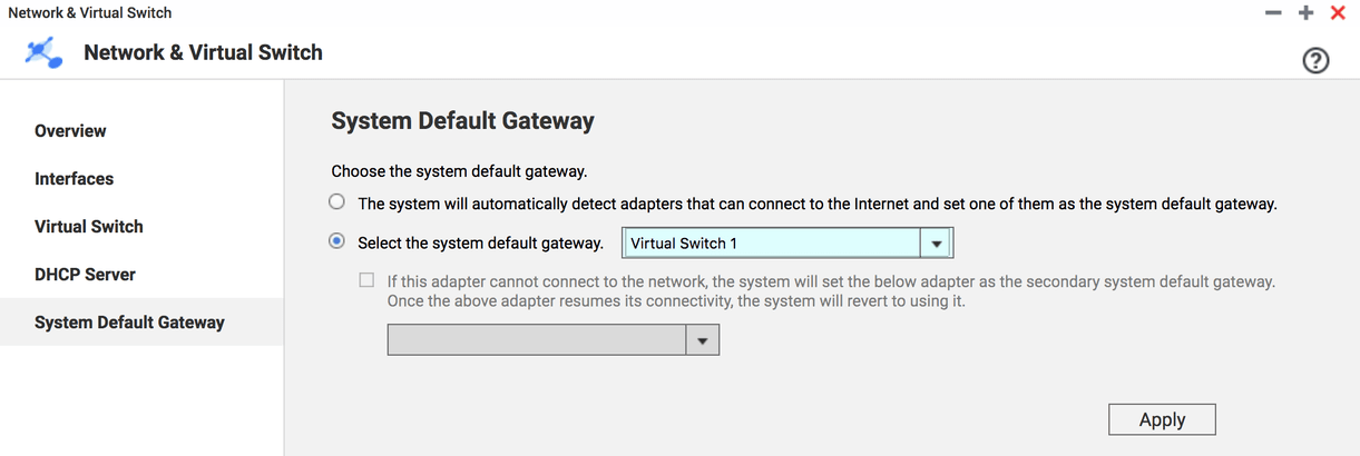

I have a few images for you. I also wonder if you have your default gateway set correctly.
I have successful docker containers running without incident. They don’t bother PMS whatsoever.
If Docker (Container Station) was interfering, you’d see 172.16.0.0 → 172.31.0.0 as an IP.
I do see a LOT of database migrations and schema complaining which I should not be seeing. Did you do a version change or fresh install?
If not, your DB is borked but a separate issue.
Also time to look at your Preferences.xml file. See, if for some bizarre reason, you have the old IP referenced there.
If you do, Stop PMS, edit it in vi and remove it then Start PMS.
The default gateway was set to the first option, in the screenshot below, where it automatically detected it. Just to try something different I selected the second option - which only has a single item on the dropdown menu.

Here is where it gets stuck and the problem as I see it.
traceroute to plex.tv (34.252.160.54), 128 hops max, 46 byte packets
1 10.35.0.1 (10.35.0.1) 5.835 ms 5.806 ms 5.997 ms
2 107.181.189.61 (107.181.189.61) 6.259 ms 6.398 ms 6.025 ms
The very first hop out is to two different subnets.
What is 10.35.0.1 ? A VM? A router ??
The paths diverge at that point… One via qwest and the other telia.

Figured it out! I couldn’t for the life of me figure out what the 10.35.0.1 address was - no router in the path, and my VPN has been off on the client machines. But that got me thinking, and I remembered I had played with enabling the VPN on the QNAP - and for some reason, it was on. Turned it off, and Plex is happy again!
So, good news is that this was 100% user error - bad news is that I’m an idiot. But thank you very much for poking at this - I was completely stumped, and it’s a huge relief to figure out. Thank you!
