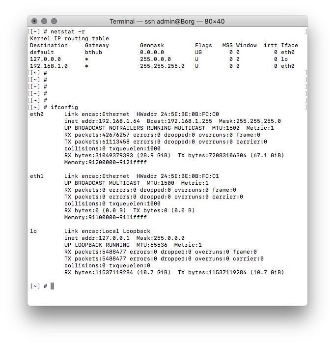

The best way to see definitively what the host has and reports to PMS is:
ifconfig
netstat -r
and examine the output

Please now allow me to be direct:
  1. Please show netstat -r output and ifconfig output
  2. Please now stop PMS, start it, with it idle, wait about 2 minutes for it to contact plex.tv and establish itself then Settings - Server - Help - Download Logs
  3. Attach the ZIP file.
I must be able to see what you see.
hi - sorry, when you previously asked me to do ifconfig and netstat -r I didn’t realise you wanted to see them yourself - so I did it and stared at the output before deciding I would google what it all meant another day.
Results below - thanks.

Now apply:
  1. Settings - Server - Network
  2. Show Advanced
  3. Lock it at eth0
  4. Turn off IPv6 in PMS. You have no IPv6 support in the host / LAN
  5. Verify IPv6 is disabled / ignore in the host networking config as well.
  6. Restart everything.
