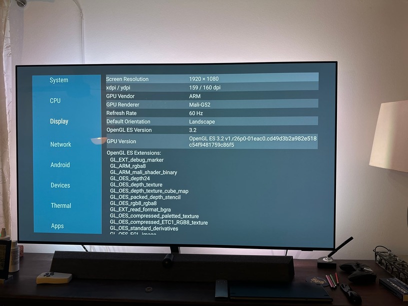

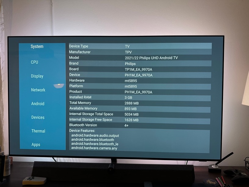

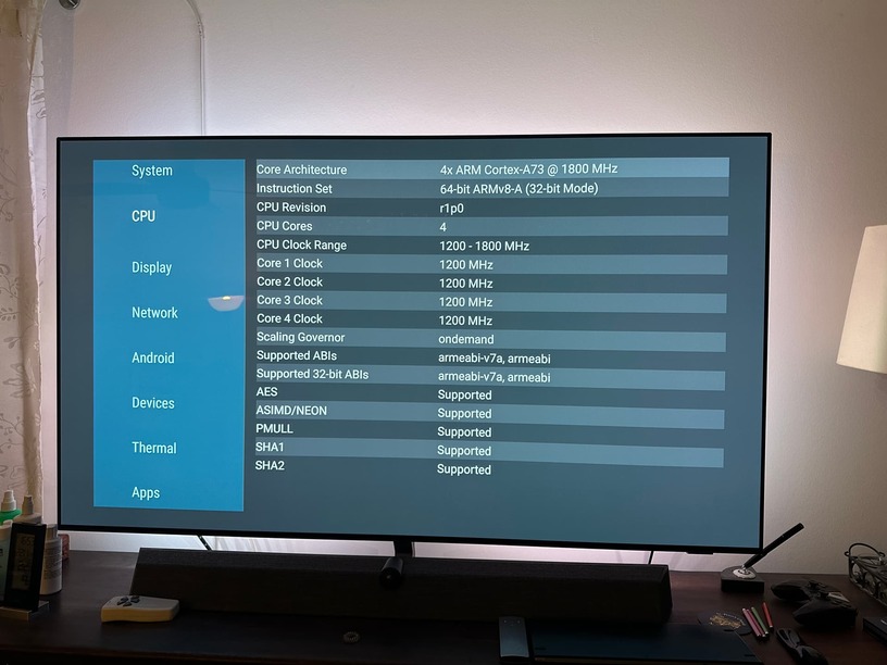

I am using a PHILIPS 65OLED937/12 OLED TV. The TV supports both DV and HDR10+. I think that is causing the problem in the new version. Like I mentioned before, everything works fine in 9.31. Here are a few AIDA64 screenshots for system information:
