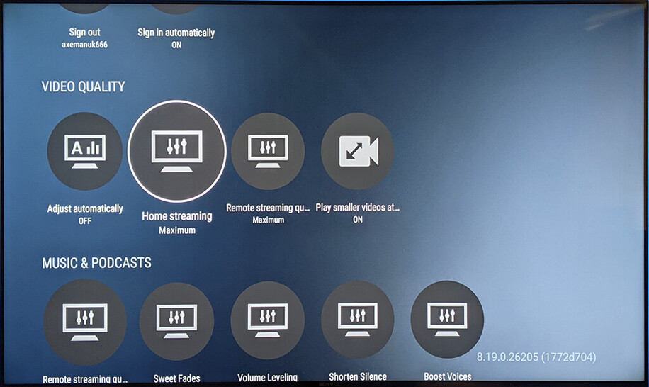

I am on 8.19 on both my 2019 Shield Pro and Sony XH95 and both are working fine.
Here are my current settings on the shield…
Although the 1 thing I do notice on 8.19 is that there is no longer a setting for Manual IP’s.
I wonder if this has been taken out??
Can you both please check if you have this setting on 8.18 and that you have also manually added the IP address of your PMS in order to combat the age old “offline useage” problem?
I have a slightly higher version that the one in your screenshot: 8.19.1.26306. That might make the difference.
I do not have an option to set a manual IP.

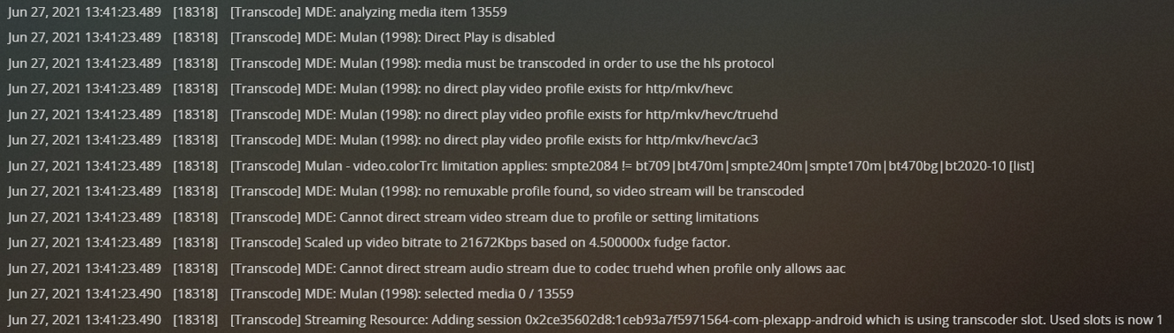

Here is a capture of my logs trying to play a 4K HDR title.
Welp, enabling HDMI passthrough seems to have cured my ills. Maybe it got disabled upon update? Not sure, but everything is Direct Playing now. I also disabled “recommended settings” under Home Streaming in the server settings and set it to Maximum.
Ah yes… That would definitely have caused a transcode.
Glad it’s now working for you :+1:
