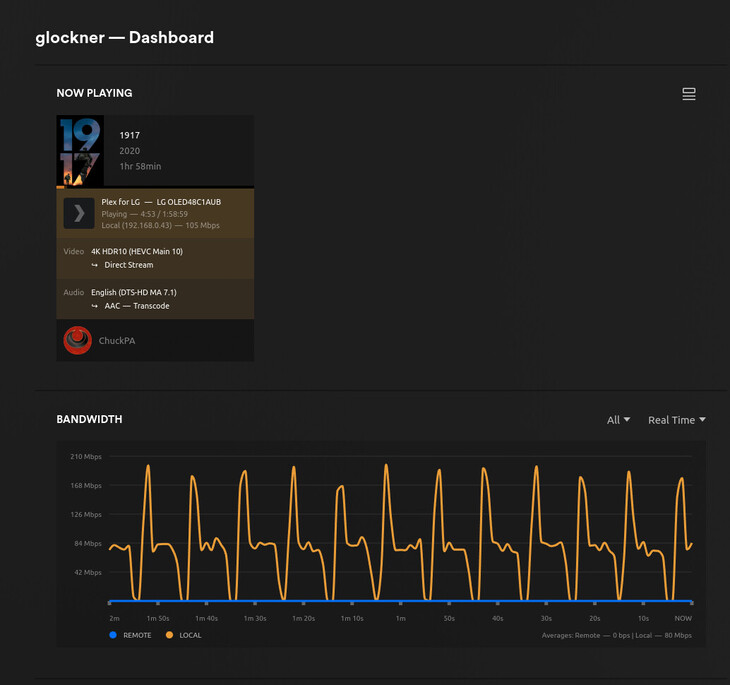

Here is a whole lot of perfect playback. DirectStream (convert audio only)

Heres my logs and a capture of the bandwidth usage. Let me know if there is anything else you need.
