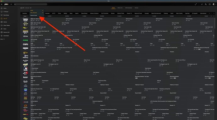

Hi there, long time between chats. Anyway , what is this Borg? Have not seen that before… I get it, it your Server Name
Try a Refresh…
Or rebuild your Guide on the Server

yes, Borg is my NAS (which accumulates all my data like …“The Borg”). This is my web logon screen:
I’ve rebuilt the EPG a couple of times, stopped/re-started the server, but I’m not sure the server is the problem as I can see the EPG when I login via https://app.plex.tv - I therefore think it’s a ‘Plex for Mac’ problem.

Works fine here, yet I’m on a Beta Version: v.1.90.1.118-a4bc1429
Hmmm, try uninstalling the Plex Mac App, drag it to the Trash, empty Trash and re install. Will have to give Permissions again.

Good shout - that did it! …maybe a hangover from the last Mac update?
