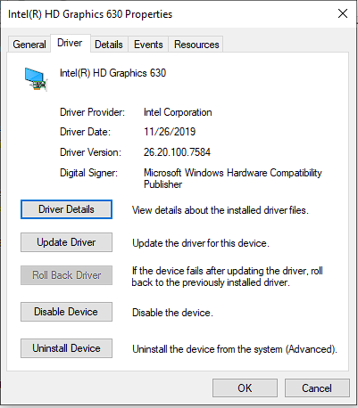

I don’t have an Intel Graphics settings on either machine when I right click the desktop. On the one with the Vega, I have the Radeon settings, which I guess I would expect since I am directly connected to the Radeon machine, and monitors hooked to it. The driver versions are the same for Intel for the HD and UHD630 on each machine.
HD630 Driver UHD630 Driver
