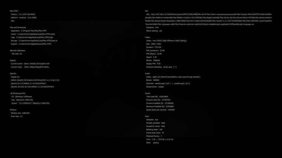

PS: I did compare the debug/info overlay between PMP and PHTPC and I am a bit puzzled by the “?” (question mark) in the info reported in PHTPC as opposed to PMP (wich states the actual d3d backend?):
PHTPC:
Hardware Decoding: dxva2-copy ( ? )
PMP:
Hardware Decoding: d3d11va (d3d11-egl-rgb)
This may not be a problem, but I find it odd anyway.
(I have attached the two screenshots of the overlays)
That’s hwdec-interop (mpv.io) and not applicable to dxva2-copy.
