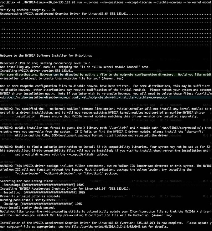

If you’re going to use the Nvidia .run file, you can do it this way inside the container.
./NVIDIA-Linux-[...].run --no-kernel-modules
The run script will put the runtimes only in the container.
Since it’s a container, it doesn’t matter if uninstallation is problematic.
That’s what I was using before, but this is even easier installing just the two library files. It didn’t have a positive effect on transcoding, if I remember correctly. I could try again if that would be helpful
Just remember to include that --no-kernel-modules option.
That’s critical inside a container.
what you had showed me was with the kernel modules.
I tried again on a clean LXC debian container using .run file drivers as follow:
Same issue, dies on webui transcoding (I tried downsampling to 480p)
