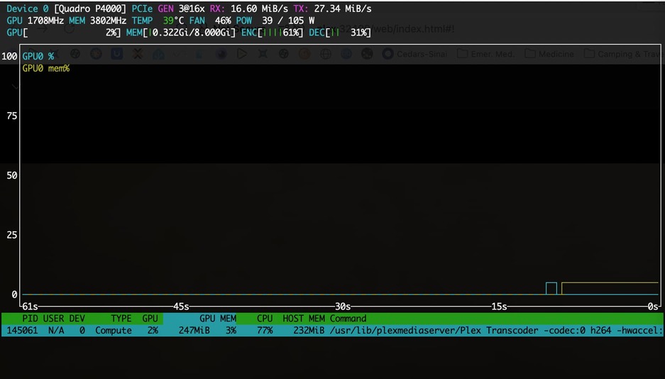

So, I’ve been working on this for the past few days trying various combinations of drivers on the proxmox host in addition to various combinations on the lxc container. Using the webui player, I can not get the transcode engine to start when requesting a downsampled transcode from the server. If I request a ā€œconvert automaticallyā€ quality, the transcode engine starts fine for playback using the web player.
This is a problem isolated to playback on the webui player. iOS downsample transcodes without issue. I’m commited to helping fix this issue if you’re available. @ChuckPa We can discuss the various iterations of trial and error I’ve run on host+lxc and host+VM if that information helps as well. This problem occurs regardless of using debian repository drivers or Nvidia direct .run time drivers and regardless of the presence of cuda drivers+toolkit on host±lxc
I was looking at this thread: NVIDIA hardware acceleration inconsistently working with web streaming - #52 by Minxster
and it seems that turning off, ā€œUse hardware-accelerated video encodingā€ also fixed the issue for me. Thoughts?

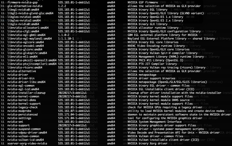

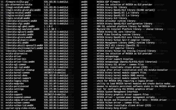

Installed host and LXC drivers:

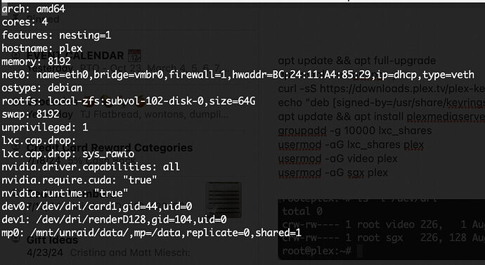

when putting PMS in a LXC,
Need:
  nvidia.driver.capabilities: all
  nvidia.require.cuda: "true"
  nvidia.runtime: "true"
Then, when PMS is installed in the container, PROVIDED the group which owns /dev/dri/renderD128 is NOT ā€˜root’, the installer will add PMS to that group.
In the case where renderD128 is owned by ā€˜root’, the installer doesn’t know it’s in a container so it opts for safety and doesn’t open the whole machine to PMS (security violation).
In these cases, where you know it’s in a container, manually adding PMS (plex:plex) to the ā€˜root’ group is ok because it can’t get out of the namespace.

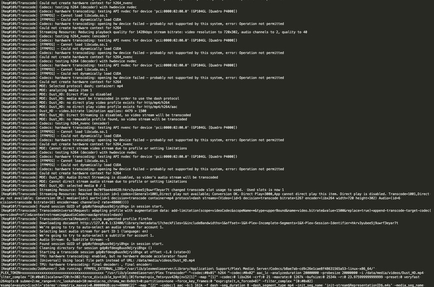

Here you can see the Nvidia is not sufficiently accessible for HW transcoding.
Aug 26, 2024 22:12:52.683 [123240458496824] DEBUG - [Req#6e/Transcode] MDE: Dust_HD: no remuxable profile found, so video stream will be transcoded
Aug 26, 2024 22:12:52.683 [123240458496824] DEBUG - [Req#6e/Transcode] Codecs: testing h264_nvenc (encoder)
Aug 26, 2024 22:12:52.683 [123240458496824] DEBUG - [Req#6e/Transcode] Codecs: hardware transcoding: testing API nvenc for device '' ()
Aug 26, 2024 22:12:52.756 [123240571743032] DEBUG - [HttpClient/HCl#2e] HTTP/1.1 (0.3s) 200 response from GET https://104-136-55-230.e9a3501c806742e4b848c1c90b3cd69a.plex.direct:32400
Aug 26, 2024 22:12:53.012 [123240458496824] DEBUG - [Req#6e/Transcode] [FFMPEG] - CUDA texture alignment: 512
Aug 26, 2024 22:12:53.028 [123240599006008] WARN - JobManager: Could not find job for handle 7559
Aug 26, 2024 22:12:53.040 [123240599006008] WARN - JobManager: Could not find job for handle 7560
Aug 26, 2024 22:12:53.052 [123240599006008] WARN - JobManager: Could not find job for handle 7561
Aug 26, 2024 22:12:53.208 [123240458496824] DEBUG - [Req#6e/Transcode] MDE: Cannot direct stream video stream due to profile or setting limitations
Aug 26, 2024 22:12:53.208 [123240458496824] DEBUG - [Req#6e/Transcode] Codecs: testing h264 (decoder) with hwdevice vaapi
Aug 26, 2024 22:12:53.209 [123240458496824] DEBUG - [Req#6e/Transcode] Codecs: hardware transcoding: testing API vaapi for device '' ()
Aug 26, 2024 22:12:53.209 [123240458496824] DEBUG - [Req#6e/Transcode] Codecs: hardware transcoding: opening hw device failed - probably not supported by this system, error: Generic error in an external library
Aug 26, 2024 22:12:53.209 [123240458496824] DEBUG - [Req#6e/Transcode] Could not create hardware context for h264
Aug 26, 2024 22:12:53.209 [123240458496824] DEBUG - [Req#6e/Transcode] Codecs: testing h264 (decoder) with hwdevice nvdec
Aug 26, 2024 22:12:53.210 [123240458496824] DEBUG - [Req#6e/Transcode] Codecs: hardware transcoding: testing API nvdec for device '' ()
Aug 26, 2024 22:12:53.460 [123240458496824] DEBUG - [Req#6e/Transcode] Codecs: Testing with profile 'High'
This needs to be resolved first.
The issue is still present regardless of modifying permissions when I only expose /dev/dri/card1 and /dev/dri/render128. Unless you want me to try also exposing the native nvidia device/drivers from the host proxmox system. I added plex to groups video (44) and sgx (which is what group 104 render is mapped to in the lxc group 104) and it’s the same.

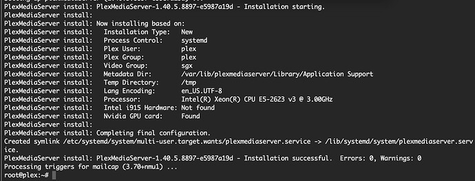

I remade my plex container to start fresh to help troubleshoot through this. My new container has the following conf:
then ran some updates and plex install::
apt update && apt full-upgrade
apt install curl gnupg -y
curl -sS https://downloads.plex.tv/plex-keys/PlexSign.key | gpg --dearmor | tee /usr/share/keyrings/plex.gpg > /dev/null
echo "deb [signed-by=/usr/share/keyrings/plex.gpg] https://downloads.plex.tv/repo/deb public main" > /etc/apt/sources.list.d/plexmediaserver.list
apt update && apt install plexmediaserver -y
groupadd -g 10000 lxc_shares
usermod -aG lxc_shares plex
usermod -aG video plex
usermod -aG sgx plex
I’ve noticed that it seems that proxmox/lxc doesn’t support those specific flags in the conf file. The following gets removed when cycling the lxc container:

Using an ubuntu container, passing along the nvidia device drivers which I remapped to the render group in ubuntu 993:
dev0: /dev/nvidia0,gid=993,uid=0
dev1: /dev/nvidiactl,gid=993,uid=0
dev2: /dev/nvidia-uvm,gid=993,uid=0
dev3: /dev/nvidia-uvm-tools,gid=993,uid=0
dev4: /dev/nvidia-caps/nvidia-cap1,gid=993,uid=0
dev5: /dev/nvidia-caps/nvidia-cap2,gid=993,uid=0
with these packages installed in the container:
allows me to transcode down once, but if I try again, the transcode runner dies. I think this is basically the same position now as I was in my first post above after having rebuilt with new containers.

I have pretty much completely simplified the process of setting up a container correctly to where it transcodes multiple times to iOS without issue, and it transcodes to webui, sometimes once, without issue, but more often than not does not transcode once. If I try to change the transcode again, the stream dies.
After setting up correct permissions on the container and passing through both the dev/card1 and render device, in addition to the five nvidia device files to allow cuda access, the only drivers needed in the container are libnvcuvid1 and libnvidia-encode1.
The following is a fresh log in which I performed the following watch actions:
  1. Began stream My_Movie.mkv in webui
  2. Transcode to 480p - fail, stopped
  3. Began stream Dust_HD in webui
  4. Transcode to 480p - fail, stopped
  5. Began stream My_Movie.mkv in ios
  6. Transcode to 480p - success
  7. Transcode to 720p - success
Plex Media Server.log (766.0 KB)
Just so we’re understanding –
  1. You say container but what you’ve done only works in a VM – but not fully.
  2. You show you’ve installed server-side drivers, in the container.
This isn’t how it’s done.
  1. Host gets ALL the drivers
  2. Runtime-only gets passed into the container
If youve created a VM, that would explain why you can’t pass the runtimes

I’ve created both an Ubuntu and Debian based LXC container in proxmox, unprivileged, to try to make this work. As an aside, even running an Ubuntu and Debian VM instance also had the same issue with full gpu pass through and only drivers installed on a vm blacklisting all drivers on the proxmox host as well.
Without installing the libraries, Plex does not detect a cuda-capable gpu. This is even with the host, also Debian based as it is proxmox, having passed all devices through to the LXC container with appropriate permissions. As soon as I installed the decode and encode libraries, it worked fine from the perspective that Plex identifies a cuda capable gpu able to encode and decode, at least when requesting a file with iOS. That is what is show in the last NVTOP screenshot above.
I’m not using docker, if that’s where some confusion is coming from, I don’t think so but I figure I would clarify. I know some people nest containers, but that’s not what I’m doing.
This is the problem point.
  1. Container
  2. But you’re trying to install the full driver – which contains kernel DKMS modules. – That won’t work You do not put kernel models and the card’s full driver in the container. The container has no kernel. It shares the host’s kernel. The full driver is to be installed on the host.
  3. All you want/need is the runtime libraries from the full driver to be passed into the container.
    (There are posts here in the forum how to do this. I can’t remember where but think you can search and find them)
