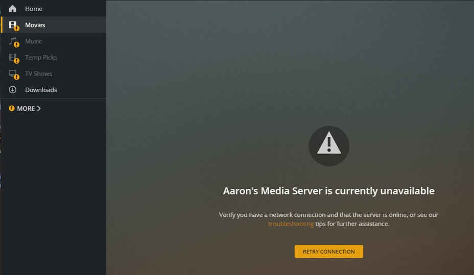

I was listening to music through Plexamp a few hours ago, and it randomly turned off. I thought nothing of it because I had other things to do, but I come back and my server is nowhere to be found.
None of the content or libraries are present, and going into the server settings, it says my server’s name is the name of my desktop, and not my actual server’s name.
I had hours worth of custom metadata content and can’t lose this server. Any idea what happened and how to get it back? I’m thinking it has something to do with this new “claim server” option, which I have never seen before.
I should also note that this cannot be a connection issue as the player is currently on the computer where the server and media is located.

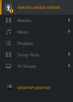

Another screenshot:
As you can see, two different servers. It seems like Plex just deleted my old server and made a new one for no reason.

Refer to the 3rd picture you posted up top and click claim server in that section of PMS…
Then perform this procedure to get access again: Why am I locked out of Server Settings and how do I get in? | Plex Support
I tried that, it doesn’t do anything. The server it claims is the new server.
So, how do I get the authentication token from that?
You won’t need it as you get a new one after this propcedure Why am I locked out of Server Settings and how do I get in? | Plex Support
Hmm, well that also did not seem to work. I still can’t access my original server’s settings (it says it’s unavailable), and it also did not restore my previous server’s library/metadata.
